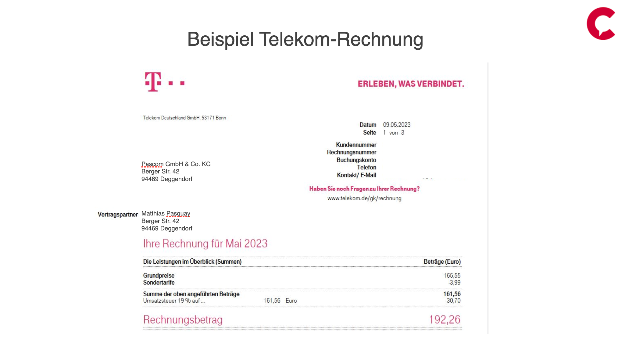

Invoice recipient is not always the same as contractual partner
The separation between the bill recipient and the contractual partner is an important aspect of number portability. In many cases, the telephone bill is issued to a specific person or organization that acts as the bill recipient. However, this is not necessarily the same person or organization that concluded the actual contract with the telecommunications provider.
  1. Bill recipient: The bill recipient is the person or organization that receives the telephone bill and is responsible for the financial aspects of the telephone contract. This role may change, for example if a telephone number is transferred from one person to another, while the bill continues to go to the original person.
  2. Contractual partner: The contractual partner is the person or organization that has concluded the actual contract with the telecommunications provider. This person or organization is responsible for all contractual agreements, services and possible terms.
With regard to number porting, it is important to note that the porting request must contain the information of the contract partner, but not that of the bill recipient. This means that the details that are stored with the transferring provider as contract partner data must be correctly specified in the porting request.
The stumbling block of changing the name - often only the billing address is changed
In the event of a change of name or company, sometimes only the billing address changes with the telecommunications provider. This can lead to problems with number porting, as the porting information relates to the contractual partner and not to the billing address.
To avoid such problems, it is important that companies not only update the billing address when changing companies, but also ensure that the contract partner data with the telecommunications provider is correct and up-to-date.
Example Telekom invoice

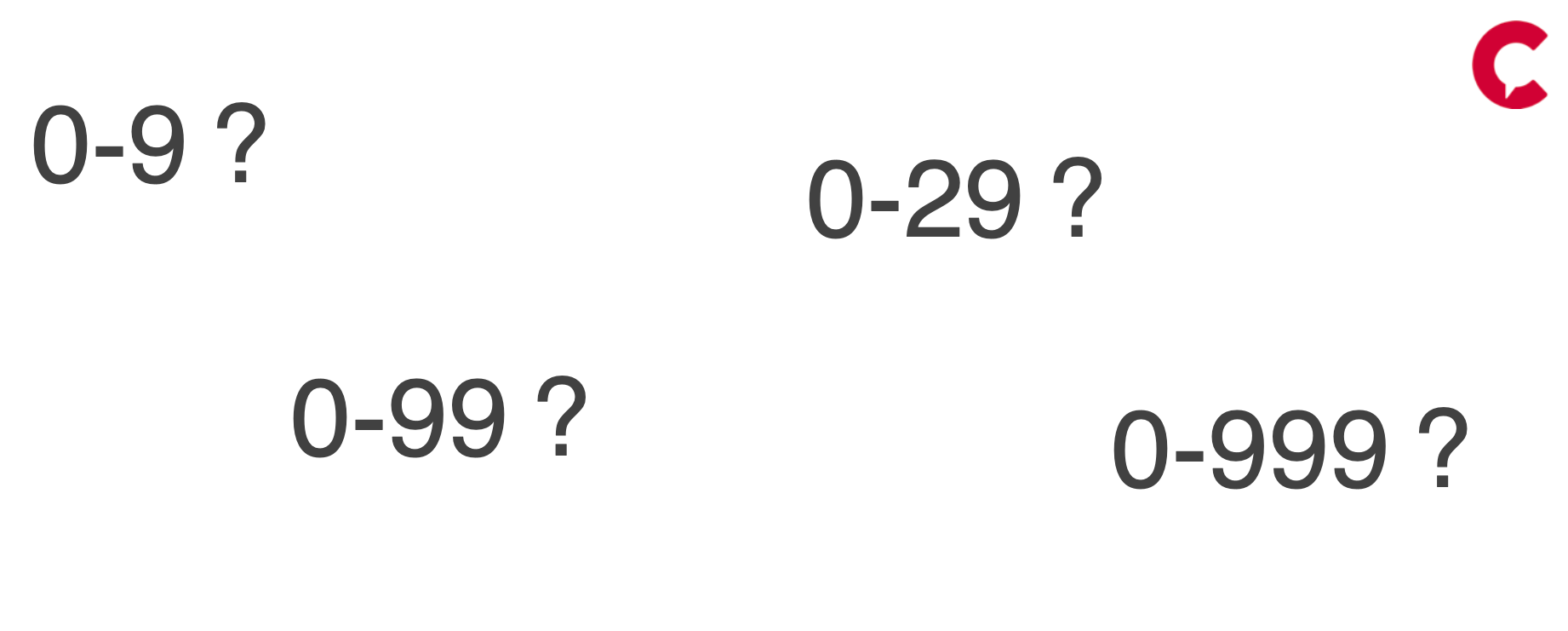

Size of the call number block is unknown
The porting process requires clear identification of the phone numbers that are to be transferred from one provider to another. If the size of the number block is not known, this could lead to difficulties in accurately identifying the numbers to be ported.
The transferring provider must be informed of the exact size of the number block to be ported in order to carry out the porting process properly. If this is not the case, an inadequate reconciliation will be generated, which may lead to the porting request being rejected.
Extension Block

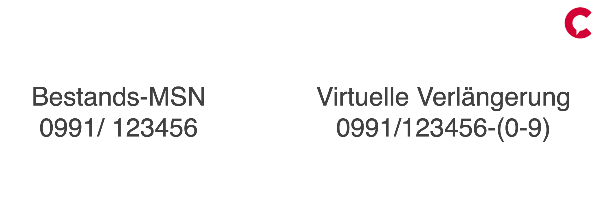

Virtual extensions complicate the porting process
Virtual number extensions feel like a number block. The porting of a number block is then often triggered, but virtual number extensions have changed a master number. The porting request is rejected because not all relevant information was available. The exact definition of the virtual extensions and their assignment to the original base number is of crucial importance here.
It is also possible that not all providers may support the porting of such virtual numbers, especially if they extend beyond a certain range. One should therefore ensure that the provider supports such porting and that all necessary steps have been taken to ensure successful porting.
Virtual Extensions

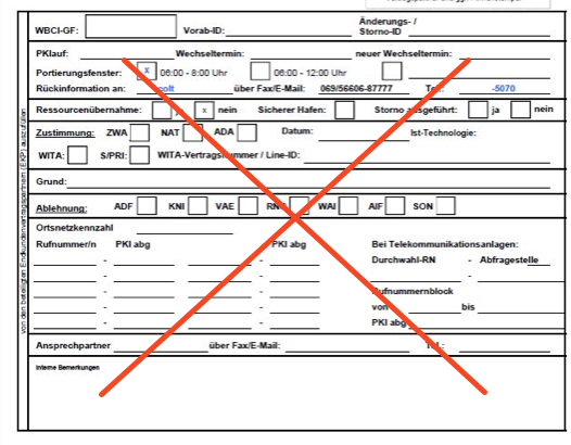

Other formal errors
To avoid formal errors and ensure successful number porting, it is important to fill out the porting order carefully, check all the required information and make sure that it can be read by the transferring provider. A porting order must contain all the necessary information clearly and completely.
The signature or company stamp is missing
Almost more important than the signature, the company stamp is sanctified on the porting request. The absence of a signature and/or company stamp on a porting request generates a 100% rejection, as these elements are considered essential parts of the application process. The signature and company stamp make the porting order legally binding. This shows that the applicant has understood the conditions of the porting and agrees to them.
Filling out the porting application beyond the specifications
Filling out the porting form beyond the specified requirements will result in the porting being rejected. The lower section of a porting request is used for internal processing by the transferring and receiving provider. Even if pre-filling this information is perhaps well-intentioned, further processing will not be possible. It is therefore best to keep your hands off it.
Lower section of the porting form
