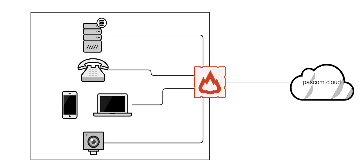

Configure your firewall
Many companies have no restricted Internet access and can therefore use the pascom server immediately, without any adjustment to the firewall.
However, if you specify exactly which Internet services your company network may access, please activate the following ports in your firewall to allow smooth operation of the PASCOM cloud phone system
Port Overview Cloud
Port Function Device Source Target

Legend
= PASCOM Server
= Desktop Client
= Mobile Client
= IP-Phone
= WebClient
