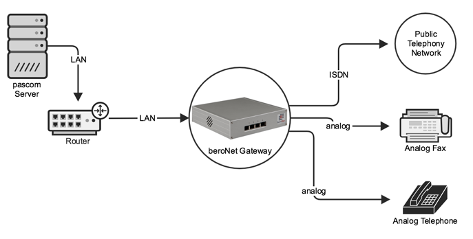

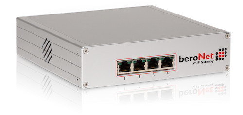

Overview
beroNet Gateways are connected via LAN and assigned an IP address from the telephone network. Connections to the public telephone network and analogue terminal devices are established using the front ports. beroNet Boxes allow for the installation of various modules. Depending on the module, the front ports are compatible with analogue or ISDN devices. Due to the LAN connection, beroNet Boxes can be easily integrated with a PASCOM virtual appliance.
beroNet Gateway

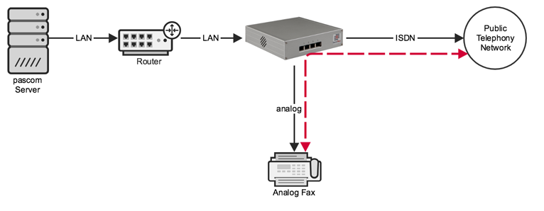

Direct Trunk Connection of Endpoints (Optional)
This function only makes sense in combination with an ISDN trunk located on the same Gateway.
If you wish to use your beroNet Gateway to operate ISDN or Analog endpoints in combination with an ISDN trunk on the same box, then use the option to directly connect the endpoints directly to the trunk without needing to route calls over the complete path to the phone system.
beroNet direct connection
Calls will not be converted to SIP and sent over the phone system server, but rather they are routed directly on the beroNet device. If, for example, there is an inbound call for the fax device, the beroNet device will directly connect it to the fax device.
The advantage of this approach is that connections are not converted to SIP, which gives superior results when fax applications are used. Direct connections can also be used if ISDN data must be transmitted.
The disadvantage here is that the PBX will not be made aware of these calls. Therefore, the server is not able to manage the call flow, e.g. forward the call to another device after a timeout, check for business hours, etc. In addition to that, the ISDN trunk and the extension must be connected to the same beroNet hardware.
Whether an endpoint should be routed directly on a trunk or via the PASCOM cloud phone system can be configured when adding the ISDN or Analog endpoint.

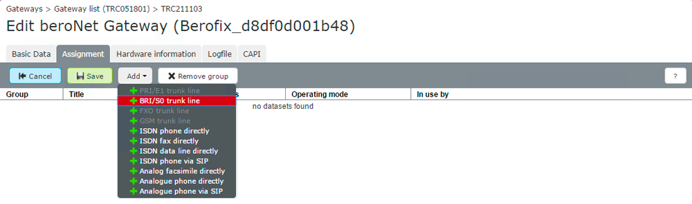

Creating ISDN trunks
A common use case for beroNet hardware is to connect ISDN trunks to it. To do so, select the gateway you want to use from the list, click the button and then switch to the Allocation tab.
Screenshot - Add ISDN Trunk
Click to configure either a BRI or PRI Trunk line .

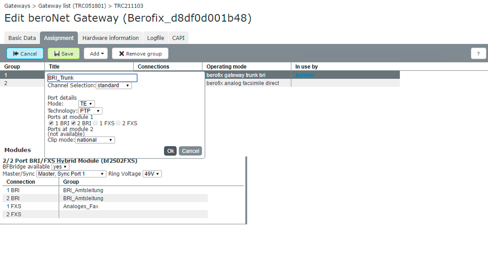

Screenshot - Add ISDN Trunk in Detail
Double-clicking on the field Name. This will open a more detailed view in which you can select which Ports are allocated to the trunk. It is possible to select multiple options here, for example, for a BRI connection multiple NTs are aggregated so they form a single trunk.
Under Mode and Technology configure the interface type. For BRI connections, the interface should be set to TE and PTP.
You have now configured the interface of the beroNet hardware. For complete functionality, you should now continue with the appropriate Trunks and Call Rules configuration under > > . To help you, use the Trunk Template beroNet Gateway.

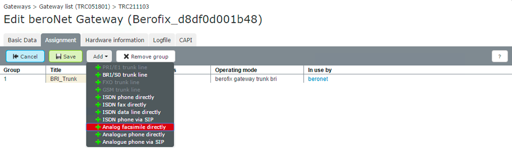

Add ISDN or Analog Terminals
Select the desired Gateway from the list and press and switch to the Allocation tab.
Screenshot - Add Analog Endpoint
The Add dropdown includes the following options:
Type Description Uses
Analogue terminal directly Analogue terminal device being routed directly on beroNet hardware Fax, door control, fire alarm system
Analogue terminal via SIP Analogue terminal device being routed on the PBX Telephones
ISDN telephone directly ISDN telephone being routed directly on beroNet hardware Emergency phone
ISDN fax directly ISDN fax being routed directly on beroNet hardware Fax server (e.g. Tobit Faxware)
ISDN data directly ISDN data transmission line being routed directly on beroNet hardware Online banking, ISDN machine control, Security alarm
ISDN telephone via SIP ISDN telephone being routed on the PBX Telephones
You have now configured the connection of the beroNet hardware. For complete functionality, you should now continue with Endpoint deployment under > > and select the appropriate endpoint type listed under from the list.
