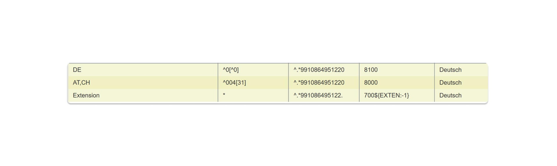

Call Routing with Regular Expressions (RegEx)
Regular expressions (RegEx) are a powerful tool for describing patterns in text. In the PASCOM cloud phone system, you can use RegEx to define flexible and precise call routes for incoming calls. This allows you to route calls based on complex criteria, such as the country of origin, the area code, or the dialed extension.
Important:
  • Leading _XXXX. means that an Asterisk standard pattern is being used, which is described further above.
  • "12345" means that a direct match for 12345 is searched for.
  • Starting with ^991 means that the RegEx function is being used.
  • Ending with [45]$ means that the RegEx function is being used.
Example - Using RegEx for Inbound Call Routing
Distinguishing between countries is very easy to set up using RegEx:
  • Germany (DE): Signaled without 49.
    • Source: ^0[^0] (RegEx: Starts with 0, followed by a character that is not 0.)
  • Austria (AT) and Switzerland (CH): Signaled with 0043 and 0041.
    • Source: ^004[31] (RegEx: Starts with 004, followed by 3 or 1.)
  • All other countries:
    • Source: * (Asterisk Pattern: Matches all inputs.)
Call Routing with RegEx
Common Mistakes
  • ^+49 is invalid because ^ activates the RegEx engine and + means that the preceding character must occur at least once. However, there cannot be a preceding character at the beginning of a string (indicated by ^).
  • ^.0991 is also not ideal because . means any single character. This would also match +0991, x0991, or 90991.
Better Solution
To handle p.e. international phone numbers more flexibly, you can use the following RegEx:
  • ^.*99129691 (RegEx: Starts with any number of characters (including none), followed by 99129691).
This would capture 004999129691, +4999129691, 0991, x99129691, and *999129691 at the same time.
