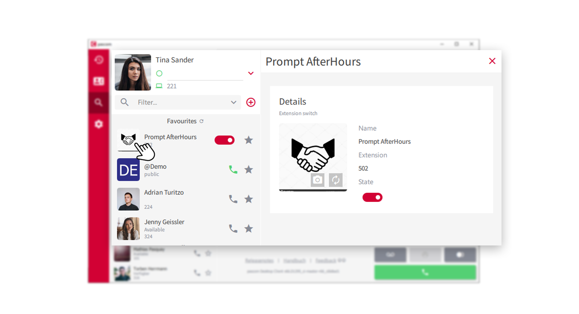

In your contact list you will find the extension switch for e.g. Prompt AfterHours.
Extension Switch in the Contact List
  1. click on the Switch/- Button to activate the extension switch.
Extension Switch activated
  1. to deactivate the extension switch, click the Switch/- Button again.
