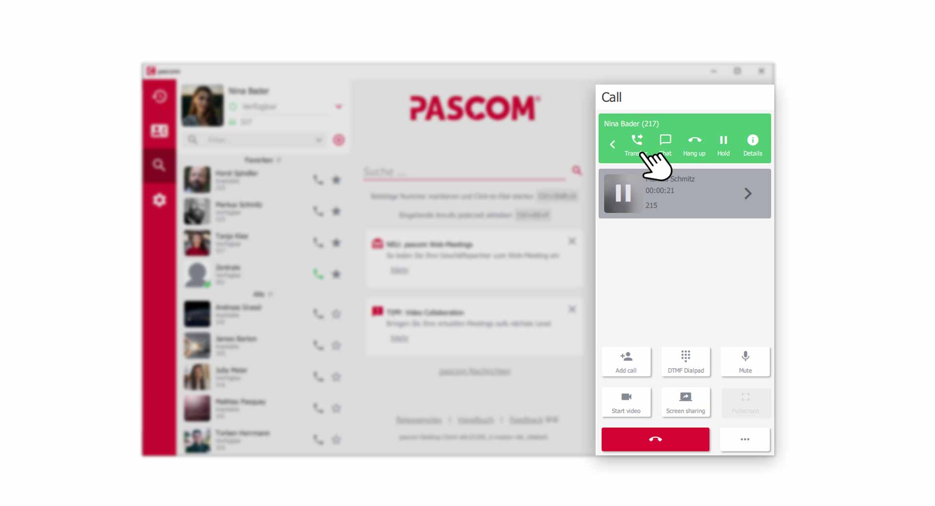

Transfer without consultation (blind transfer)
Forwarding a call partner blind without consultation is not appreciated by colleagues, because the call is simply put through without further information. However, it is a quick option to forward the caller to the desired colleague.
  1. select in the call element.
Step 1 Blind Transfer
  1. enter the dialling number or the name of your colleague in the dialing field and click on the to connect the call
Step 2 Blind Transfer

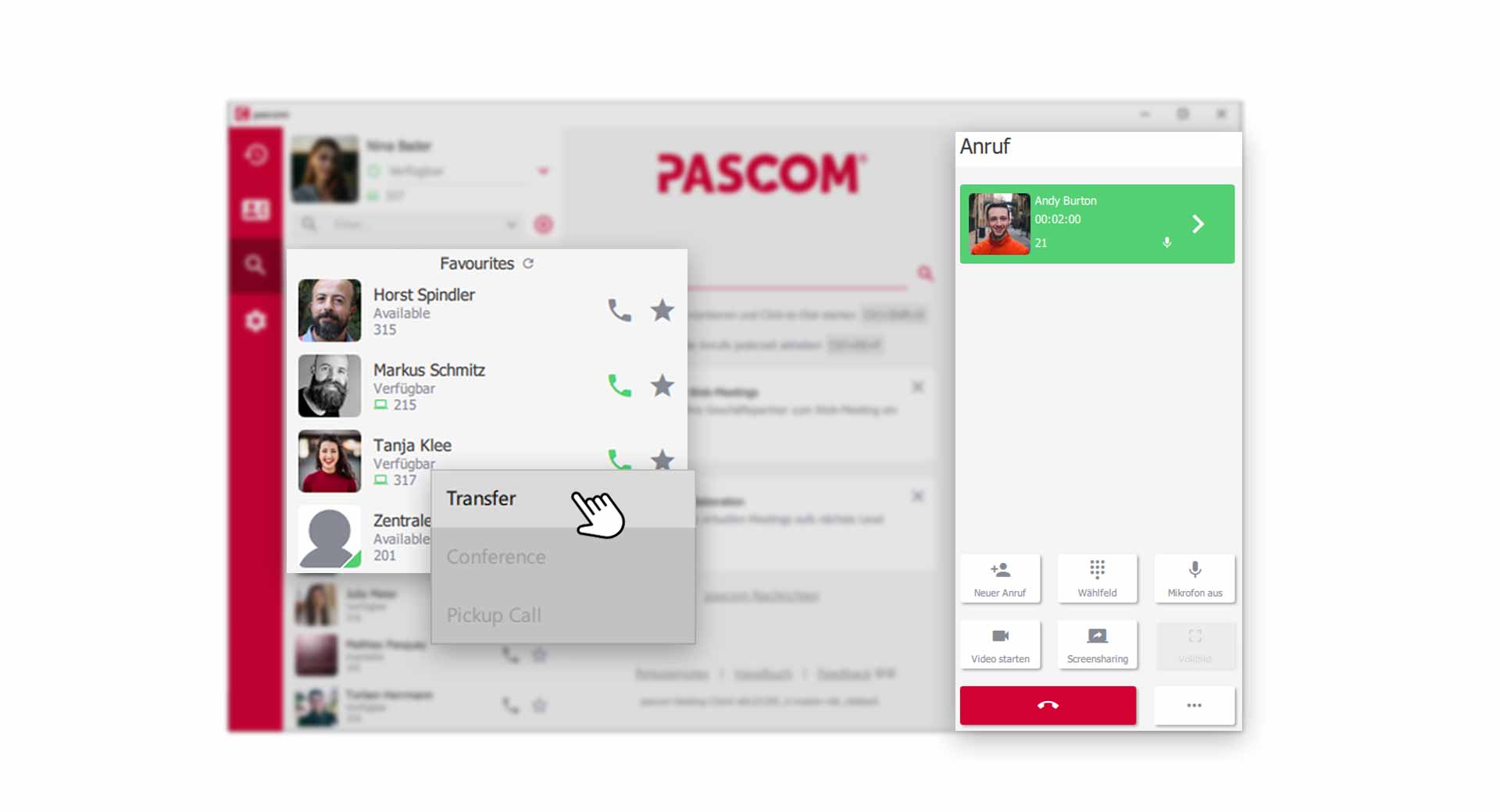

  1. Alternatively, you can click on a colleague in your contact list with the right mouse button during an active call and select the item in the Pop-Up menu.
Step 3 Blind Transfer

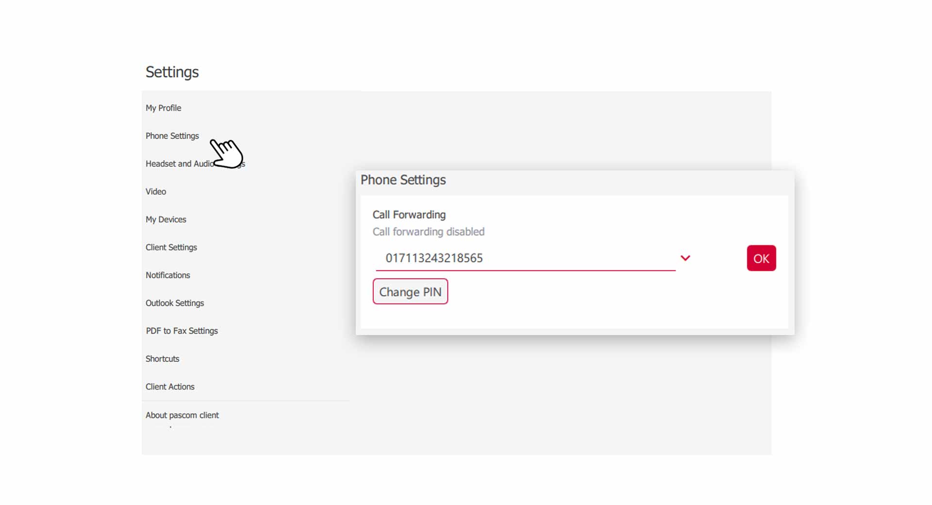

Call forwading
You want to forward all incoming calls to a colleague or a phone number. No problem, the PASCOM client offers the possibility to set up a call forwarding in the settings. The system administrator must have set up a corresponding authorization role to set up call forwarding for you.
  1. Open the via the PASCOM menu.
Open Client Settings
  1. Click on in the Settings menu
Set up call forwarding
Set call forwarding
In the input line enter the desired phone number to which you want to redirect. If a predefined call forwarding have already been set by the system administrator, you can select them from the drop-down menu by clicking on the input line.
