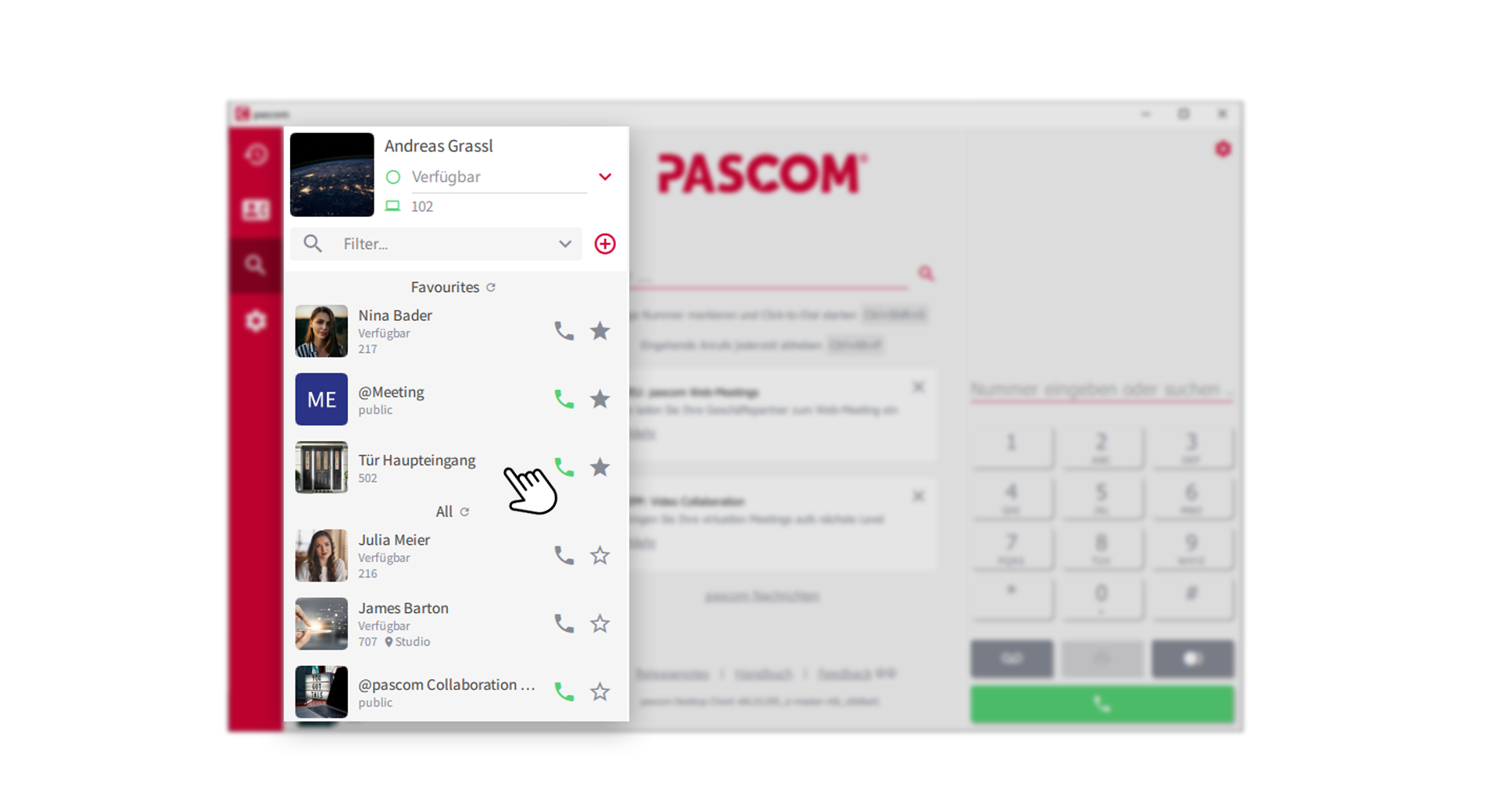

In your contact list you will find the Intercom.
Intercom in Contact List
  1. If you click on the Intercom element in the contact list, you will be taken to the overview of the door intercom system, where you can view further information.

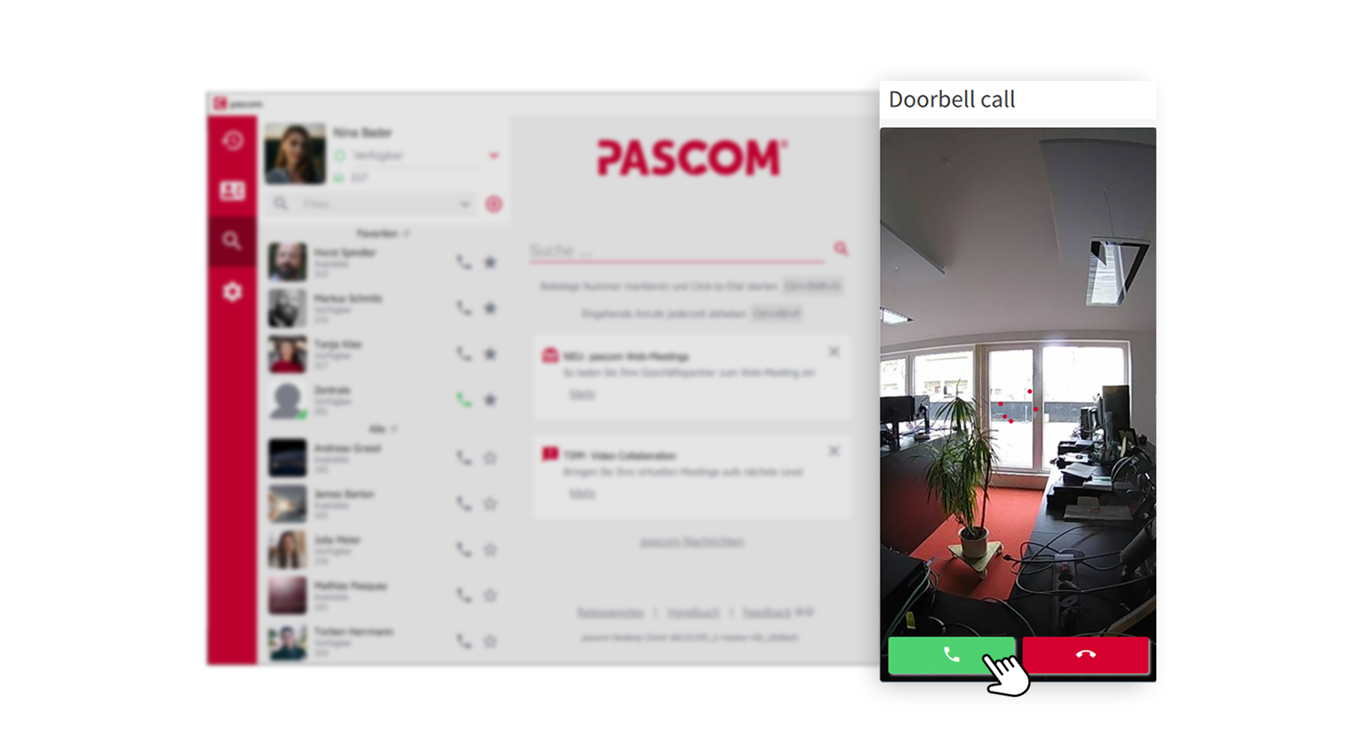

Someone rings the door bell
If someone presses the bell at your door intercom, the intercom sets up a call and calls you. You receive the call in the pascom Dekstop Client, on the Mobile Client and also on a hardware phone.
Door intercom is calling

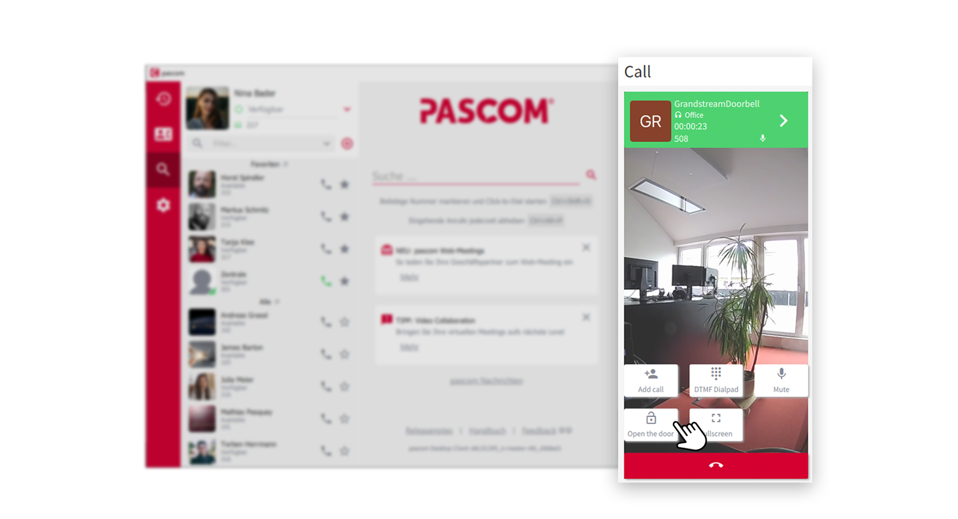

  1. You can already see in advance, via the video stream, who is standing in front of your door. Now accept the call via the green receiver icon. You are now connected to the visitor via the intercom.
Door intercom active call
  1. To open the door for the visitor, click the door opener icon.
  2. To end the call, simply hang up via the red receiver icon.
