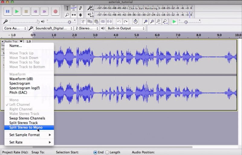

The first step is to convert your recording from Stereo to Mono. The reason here is that one a telephone, it is highly unlikely that you will ever have access to stereo sound quality as telephones are mono aural. Another reason for doing this is that by using the microphone, the recording was made in mono anyway. You could record your whole project in mono, but should you wish to mix in music with your prompts then it is best to leave the project in stereo and then convert the project to mono once you are happy with the recording.
Should you be, like us, using Audacity then splitting the track to mono is very straightforward. All you need to do is select “Split Stereo to Mono” via the drop down menu arrow icon on the left hand side of your track as illustrated below:
Asterisk IVR prompt recordings with Audacity
Once the tracks have been split, you can delete your now surplus to requirements second recording track.
